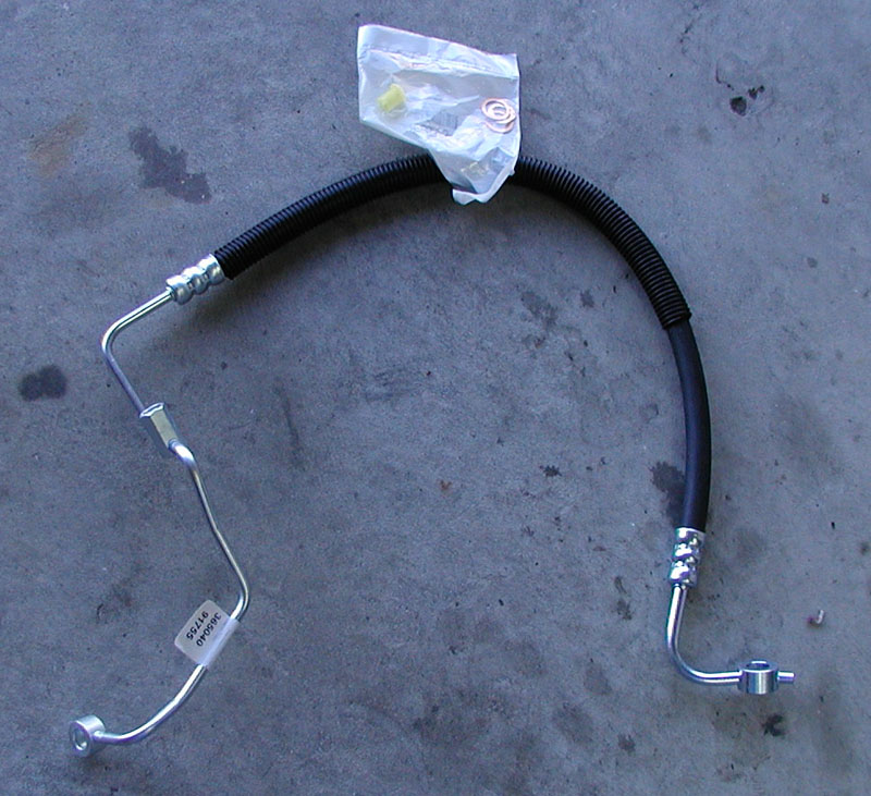

Message you do need to swap over the pressure sensor. Be careful not to damage the wires that come off of it. I recommend you remove the whole assembly and swap the sensor when you have the hoses out of the car. Fitment is fine on NAs and 94+ TTs - it doesn't fit on 90-93 TT due to fluid HICAS lines.
Here is the aftermarket one:
